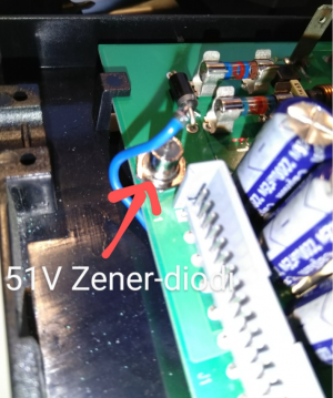

Hello from Finland. I broke my C 6002 EH fan motor from my motorhome and replaced it with a newer model motor that damaged the circuit board mosfet. The problem is that the newer fan motor gives a voltage spike to the mosfet when it shuts down and breaks the mosfet (IRF4095). Mosfet breakage can be prevented by installing a 51v zener diode in the mosfet. Since then, the new fan motor has been operating normally without breaking the mosfet.
