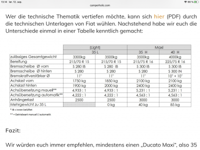

15 inch wheels are normal fit on a light chassis. The major difference is that the maxi or heavy chassis has 16 inch wheels with a 130 mm PCD for the thicker wheel bolts. The suspension is uprated with HD shock absorbers and springs, both the front and rear axle allowed loads are higher at 2100kg front and 2400kg rear.(1850 kg, 2000kg on the light chassis). The brakes have larger diameter disks with HD hubs. (300mm dia on the heavy, 280mm dia on the light). The tyres normally fitted are 225/75/16 load rating 121/120.
PrunesDK
81
Kalundborg
29810
Både Fiat Ducato Light og Maxi findes i forskellige versioner, her er lidt info. Tjek akselvægt på på typeskiltet.
